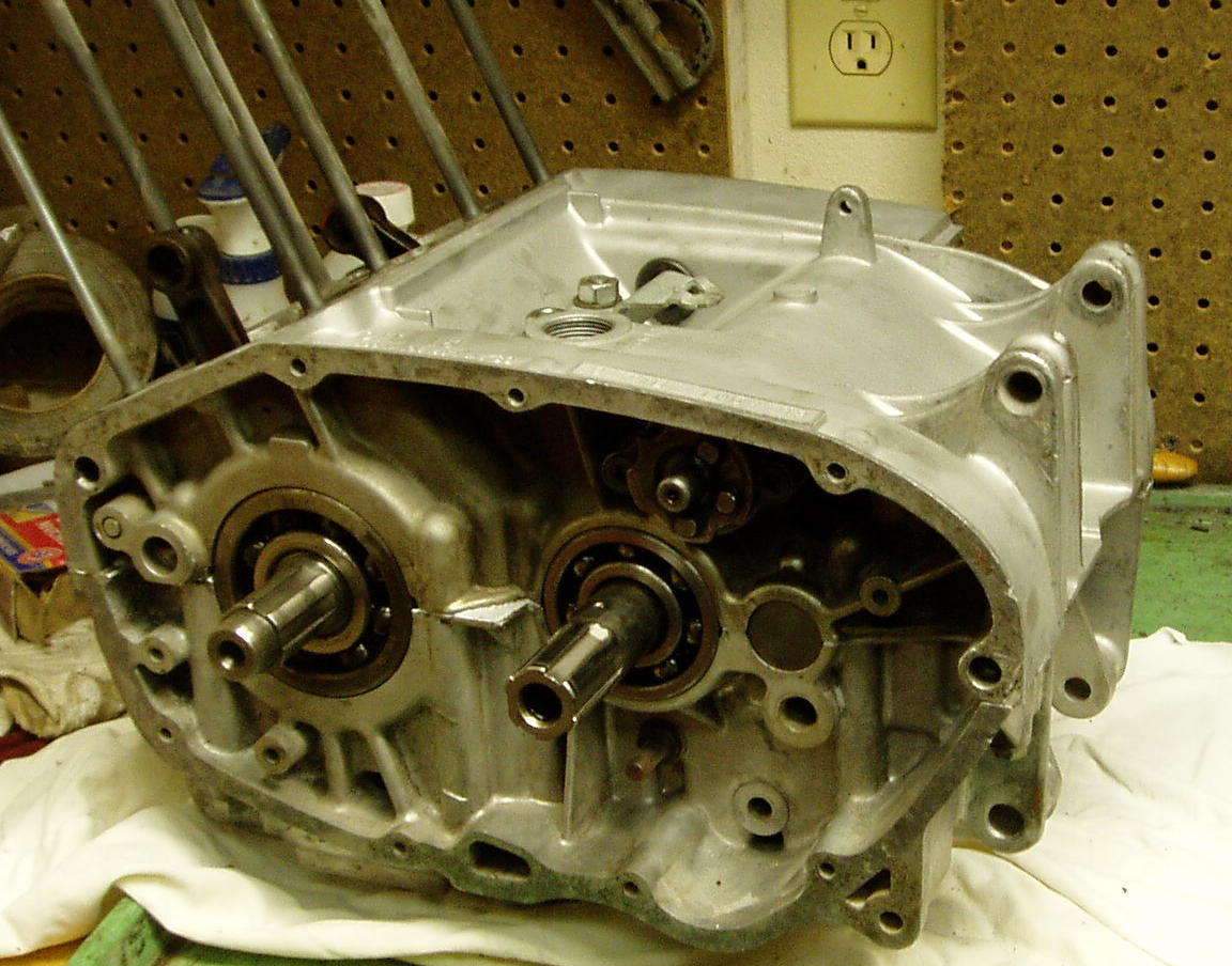

After riding this old rag with her oil leaks and such, and now that I have my second cl road worthy; it is now time to give restoration a try. So here goes. Now I've torn her down to a heap of parts.
The first thing I found in this engine had 4mm over pistons. 350 kit maybe? Then I noticed that the case was not sealed with hondabond but a rtv sealer which explains the oil leaking from the front seams.

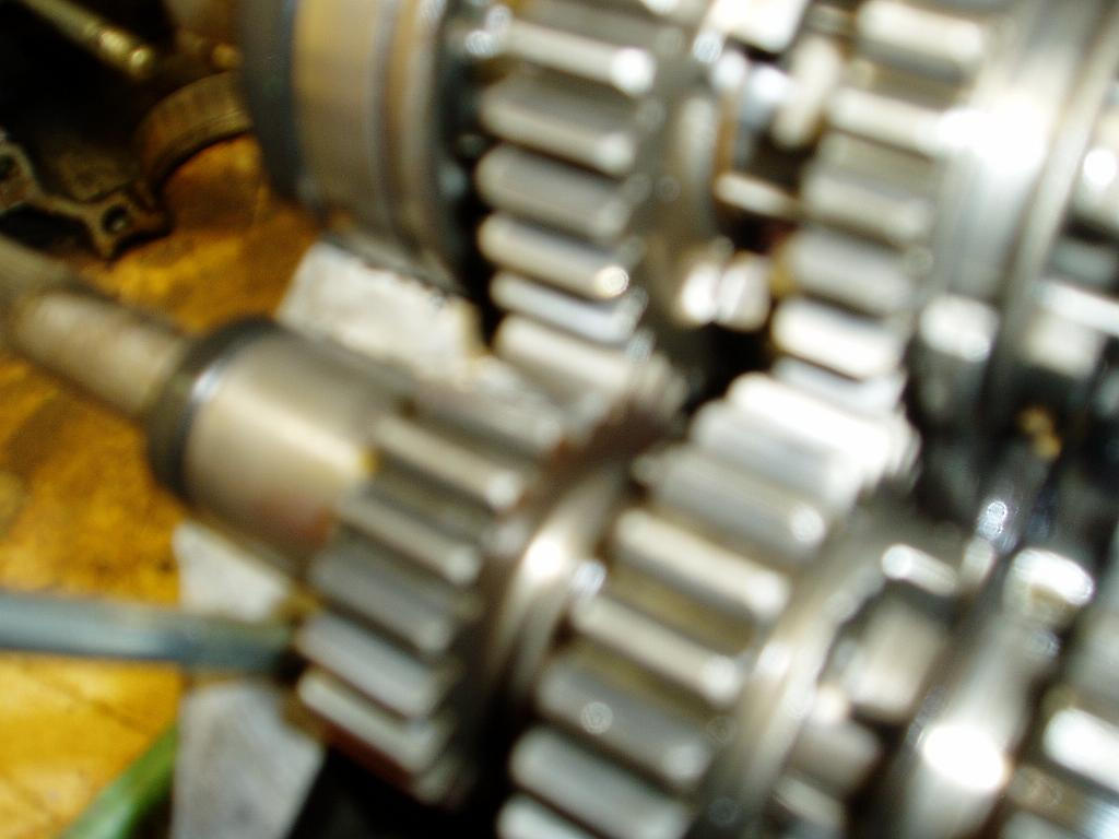

When I got to the trans. I found a gear with a missing tooth, a badly worn bushing and a k/s pawl nearly worn through to the point that I'm surprised it even worked. A closer exam revealed the gears were x-ed so I was riding an x-geared bike and didn't know it. This learning thing can be fun.
So here we go with a whole lot of time and money and in 6 mo. to a year I hope to get her Back to a pretty bike again. It won;t be as nice as Davomoto's but it will be one I'll be proud to ride to town. Here some pics the way it was. RW

First: The trans. I found had some more issues with third gear not engaging enough. To solve that I found a shift fork with more meat on that side and that helped. Then I decided to use an offset cotter to move the gear a bit closer. Good enough for Honda, good enough for me. Long story longer; I put together a very tight and sound transmission. I sure hope I don't have to eat those words one day.
