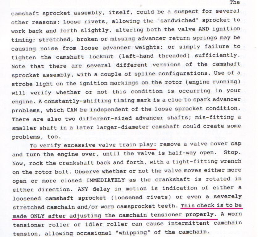

Listen to Ed, Jason. His method works first time, every time. But, it could all be in vain if your motor's valve train isn't correct:
  • 1. adjust the camchain tensioner, as per the handbook/manual
    2. adjust the valve clearances, as per the handbook/manual
    3. check that there's no valve train backlash as described in the attached pic
    4. http://www.honda305.com/forum/index.htm and click on FAQ in the left pane; follow Ed's recipe

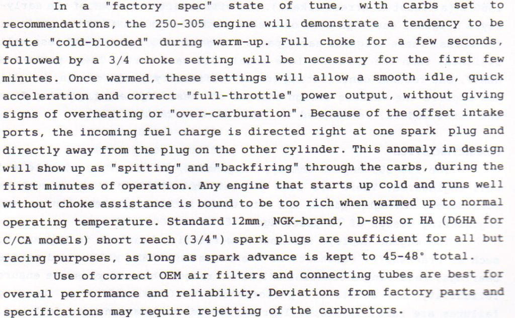

Back-popping from the carbs is normal on twin carb models. There is a logical reason for this on our motors, which I've read but escapes me just now. I also seem to remember reading that it's only one side that back-pops(?).
EDIT: not once the motor is fully warmed.
I knew I'd read this somewhere and wasn't going prematurely senile:
