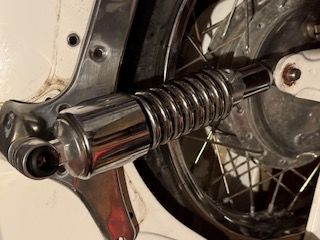

Need some more help or advice. I have a 65 CA78 Dream and the rear shocks have a chrome spring on the outside. I was wanting to repaint the frame and was wanting to remove the outside spring and shocks. They look different then my rebuilt diagrams. Do I need a spring compressor to remove these or is there another better method? (Maybe just tape off around the chrome rack attachment).

Thank you for the response and help. I attached a photo of what I have.

Original shocks can be hard to find and are almost certainly worn out. Yours aren't bad looking though and if they work, well you have something to ride.

If you mean a piston ring compressor, I can't see how that would help. Just looking at the shock I think that the chromed cover sits under the aluminum casting. You would need to take the spring pressure off the casting in order to unscrew it from the centre rod and you would do this by pulling down the cover, compressing the spring.
There may be universal compressors that a bike shop would use so it might be worthwhile checking out some dealers or repair shops. Otherwise you'll have to make (or have made) something like the one in the picture. Whatever you do, be careful. There's a lot of energy stored in the spring. It can hurt you if it is released in an uncontrolled way.
