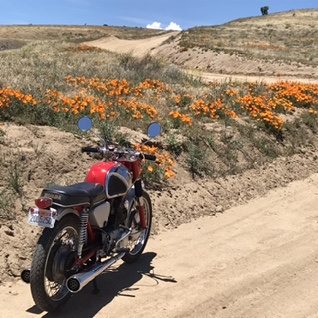

The next picture shows me after turning back, pulled over on a bright desert highway. Using my Swiss Army knife and tool roll, I retarded the ignition to cool down the combustion temperatures. This allowed me to make it 120 miles back home, including over the challenging Angeles Crest range.

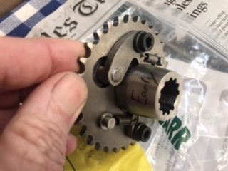

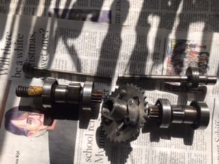

With the help of several on this forum, and using my timing light to observe dynamic ignition timing, I could see that when the static timing was right on, the max advance was about 11 degrees past the marks. This is caused by wear in the advance mechanism, in particular, the neoprene ring on the advance limiter pins were worn away. A member of this Forum, Tim Miller, has engineered a fix for this. About two weeks ago I sent my cam sprocket to him for repair. This was done in a few days for a very reasonable $125, and featured a rebuild of the old mechanism with improvements in several areas, especially a hardened steel replacement for the stock neoprene-covered advance limiter pin.
I reassembled the head lastThursday, and installed the motor Friday. As usual with these projects, I took the opportunity to make other repairs along the way. The motor fired up after a few kicks, and I am very happy with the results. The power and response is much better now starting from a stop, and driving around at moderate RPM. For now, I'm enjoying a transformed bike, the way a CB77 should run.

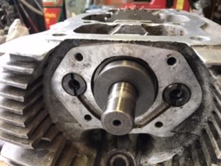

I’ll try to add photos of the bike near its breakdown spot, and the beautiful advance mechanism along with the world’s most complicated camshaft assembly.

Tim Miller
- Posts: 242
- Joined: Mon Jan 30, 2012 6:22 pm
- Location: Pflugerville, TX
Re: Engine seizure/advance repair
Thanks Larry!
I’ve been modifying these for 15+ years and it’s by far the best performance modification you can do.
It also fixes the loose rivets/gear problem.
When I first tried this I was concerned about excessive noise when the bob weight stops made contact with cam gear, but there’s no noise. I suppose Honda’s eager engineers back in the day though the rubber was necessary to keep the weights quiet or just not to bounce? but it’s not necessary, there’s no evidence of erratic timing visible with the strobe light and there’s no noise.

Tim,
Yes indeed, the engine response has been transformed by your rebuild. I can now detect some small adjustments needed to carburetion which were previously masked. And I could not hear any additional noise.
I admit I was surprised at the violence needed to remove the sprocket. I don't like hammering on ball bearings to remove them. There are 4 bearings supporting the cam, and for some the removal force is transferred through the balls, which I always thought was a no-no. My advice to others is to plan on replacing at least some of the bearings if you do this.
I may have been doing it wrong, but can see no way to avoid the hammering.
