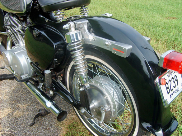

                    Here's a project I just finished.  Once in a
                    while I like to do something a little different.  No welding
                    was done on this bike so I could return it to 'normal'
                    again, if I didn't like it.  All stock and original except:
                    Harley chain guard, Super Hawk front wheel and hub, seat,
                    rear shocks, air filter, and a valley cover.
                    I enjoyed doing this project.  I thought,
                    for a month or two,  of how exactly I wanted to do this
                    without cutting or welding any parts,  everything can be put
                    back original very easily.  It came together pretty much
                    like I had intended, except I originally wanted a white bike
                    with blackened cylinder and head and all the chrome painted
                    dark charcoal with a high gloss. Black Chrome would also
                    have been nice.  The bike is all original except for the
                    handlebars, mufflers, shocks, seat, chain guard (Harley) and
                    the front wheel assembly which came from a Super Hawk.  The
                    stretch was accomplished with 2 metal straps which added 4
                    1/2" to the wheel base.  This is really just a good rider as
                    many things could be done to make her show quality, like
                    rechroming some of the parts, plastic badges and a better
                    paint job.  It still has a few small dings here and there.
                    It certainly gets a lot of attention and questions.  I just
                    wanted a different look without damaging the original bike.
                    Hope you guys like her.  A true labor of
                    love.
